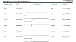

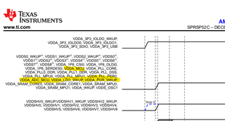

In the user guide for the TPS65941319-Q1, Table 3-1 lists the domain "VDDA_ADC_WKUP".
Should this be "VDDA_ADC_MCU" (pins M7, M9) instead?
Thank you.
Thank you.
Hello Michael,
You are correct, from crosschecking the datasheet for the AM65X
The correct name for the domain is VDDA_ADC_MCU, not VDDA_ADC_WKUP, thank you for pointing this out.
BR,
Nicholas McNamara
