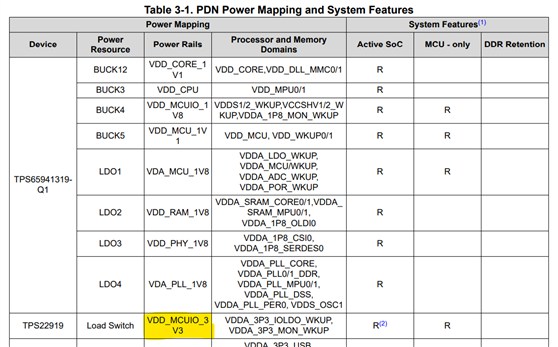

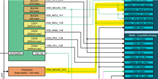

In the user guide for TPS65941319-Q1, VDD_MCUIO_3V3 is shown to be the power rail for the VDDSHV0_WKUP supply group in Figure 3-1:
However, the VDDSHV0_WKUP domain is not listed next to the VDD_MCUIO_3V3 power rail in Table 3-1:
I assume this is just a typo, but wanted to confirm.
