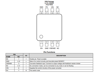

Hi Team
Float to enable, how about high or low level? how to control device's enable or disable?
Hi Team
Hi Harry, To disable the device, you pull the EN voltage below the enable threshold.
Britton
Hi Britton
Thanks for your feedback. Is there an internal pull-up to enable this device if the pin is floating external?
That's correct. If this helped, please help us recommend this answer to other e2e users by clicking on the resolved button on the response above.
