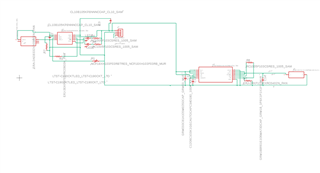

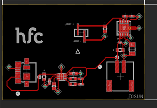

Hello All,
Can you verify my design?
below 50mA external RC circuitry needed, since load will take at least 30mA,  designing for 90mA charging current : ISET to GND 3.3kohm
VSET TO GND 47.5kohm
CL10B105KP8NNNC 1uf
ERJ-3EKF4752V   47.5k
ERA-2AEB332X 3.3k
LTST-C190CKT red LED
RC1005F103CS  10k
