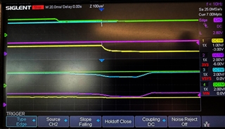

We observe an occasional VSYS drop in our design.
It happens under the VIN switching stress test. In this test, we simulate short bursts of unstable VIN by switching it on and off every 4 seconds for 10 attempts, with a relaxation period of a few minutes to allow battery charge.
The observation is:
1. After switching off the external supply, VIN drops down to the VINDPM limit
2. After 60 ms, there is a short (~500 us) dip in VSYS voltage.
Diagram of this event:
Unfortunately, this diagram doesn't capture the VBAT voltage, but the battery is ok (ESR <150 mOhm).
The reproduction happens at different VBAT voltage levels, slightly correlating with the VSYSMIN limit.
The reproduction correlates with a system load.

Could you suggest possible reasons for such a VSYS drop? The issue is tough to reproduce, and understanding which events may lead to such behaviour may help us localize the issue.

    If possible, can you share waveforms including VIN, VSYS, VBAT, and IBAT or ISYS?
    This could be caused due to a load pulse applied to VSYS while VIN is VINDPM limited. The current limitation on VIN indicates that a load pulse on SYS would require additional current to be pulled from VBAT. I would confirm that VBAT voltage close to the IC pin remains stable. In some applications we can see that the trace and equivalent resistance of the battery will cause the VBAT pin voltage to drop due to the IR drop when a load pulse is applied. Including the VBAT waveform might help to identify if this is a possible cause.

    Yes the VBAT_DPL is a threshold to keep an eye out for. In this input current limited state your VSYS will closely track your VBAT voltage since there isn't enough current to sustain VSYSMIN regulation. In this case it is very possible that VBAT voltage is dropping without crossing the VBAT_DPL threshold and SYS is simply tracking that voltage down. In either case a capture of VBAT voltage close to the BQ's pin should provide useful context.
