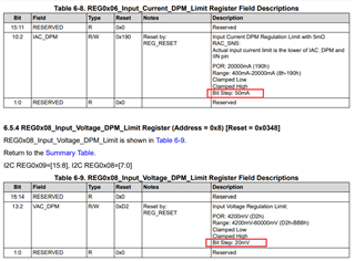

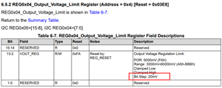

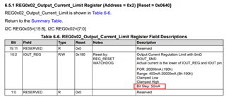

We use the BQStudio with your firmware is well but it can read the register but not write the register, so we find the Bit Step is wrong in the datasheet,
can you help to check if they below Bit Step is wrong or not?
The bit step is correct in the datasheet. Can you be more specific on the issue you are facing? How have you determined that BQStudio is not writing to the registers properly? Are you seeing a Device ACK ERROR at the top of your screen?
