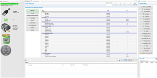

I'm testing with the EV2400 and BQ27Z561-EVM, but once the device gets sealed, I'm unable to modify any values. Could you please let me know how to unseal it?

You can use the "UNSEAL_FULL_ACCESS" button in the lower right hand corner to unseal the gauge and you can also reference this e2e below as well.

When I press the Reset button in the Command window, it switches back to SEAL mode. Is this expected behavior? Also, sometimes pressing the UNSEAL or UNSEAL_FULL_ACCESS buttons in the Command window successfully unlocks the device, but other times it doesn’t. Is there a specific procedure required to unlock it?
-Resting the system revert the battery gauge back to it last known state so it can be typical to see it go back to seal mode
-It could be the communication bus becomes to busy thus you can prevent this by having the system not "Scan" or "Auto refresh is ON - click to Turn OFF"
