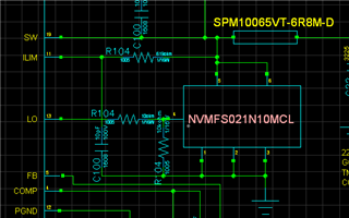

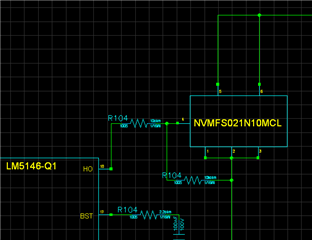

3. added the stable resistor in external MOSFET
In eval board, there is not any resistor around external mosfet.
But about 10ohm Gate resistor helps to avoid rush current or control switching frequency.
And about 10Kohm resistor between Gate and source can disspate electric on gate and prevent boot loss.
I want to make this on the circuit, is it okay to use like below?
    Yes you can add the gate resistor in your design as well as the Gate Source Resistor in your design.
    However, please be aware that these are lossy elements in your circuit and will add power consumption and make the efficiency of the design worse. I would recommend that you use only if necessary. I have seen multiple designs work perfectly fine (including the EVM) without using these resistors.
    Taru
  • Just to add what Taru mentioned, putting a resistor on the low-side FET gate is a bad idea (it causes Cdv/dt shoot-though). The EVM has a 2.2Ω resistor in series with the boot cap - this is sufficient to control high-side FET switching if needed.
    PS: If Vin is only 24V, you can use the LM5145-Q1 (rated to 75V input) instead of the LM5146- Q1 (100V). 100V FETs may not be needed here (60V or 80V may be sufficient).
