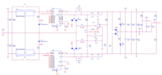

my design is a dual tracking power supply using TPS7A4701, TPS7A3301 and OPA992S.
Attached the simulation and the schematic (BAT54A was corrected with BAT54S).
Simulation seems good but when we measure the output voltages on the pcb we have +4.9V/-5.2V and not +5V/-5V.
When we disassemble the circuit section of the OPA and close JP2 and JP4 the voltages balance each other at +5V/-5V.
What could be the problem?
Thanks for your support.
2818.Dual Tracking Power Supply.TSC
  • Hi HD,
    Can you measure voltages at the inverting and noninverting inputs of the OPA992, as well as its output? If it's possible to measure input current into each LDO, that would be useful to know as well.
    Alex Davis

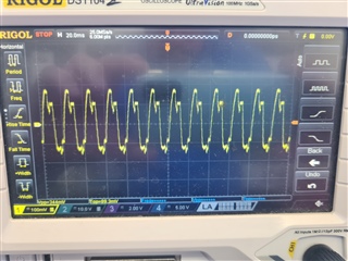

  • Hi Alex,
    we tried it on 3 boards but the result is the same. It is strange because the simulation seems to work.
    Attached a scopepicture about the output of OPA992S.
    Let me know.
    HD
  • Hi HD,
    That oscillation makes me wonder if there's a characteristic of the LDOs that's not captured in the SPICE models. The TPS7A3301 model in particular seems to be very basic and may not fully depict the behavior of the actual device.
    Unfortunately, a full stability analysis isn't doable with the models we have right now. As a first step, I'd try increasing C306 to 100nF.
    Alex Davis
  • Hi Alex,
    I tried to increasing C306 to 100nF but nothing changes.
    We tried also to decrease R268 to105K-106K and to reduce the gain decreasing R272 to 47K but nothing...
    There must be something that does not allow the OPA to regulate well.
    HD

  • Hi Alex,
    there are about 20 op-amps (+5/-5V dual supply) as load.
    Oscillation is no longer present with C306=100nF, but the output voltages remain +4.94V/-5.2V.
    We also tried to lower the op amp gain from 2 to 1.3 without results. We also lowered the resistors from 107K and 102K to 47K obviously maintaining the ratios with the higher resistors, i.e. the 274K became 120K and the 332K became 153K but without results. We did this thinking about the fact that the op amp is unable to close the loop and therefore by lowering the resistors from 107K and 102K we could favor its feedback. In fact it is strange that being a non-inverting, it has a negative value at the input and a positive value at the output. Probably we need to further lower these values ​​of the lower resistors?
    The reason for choosing balanced voltages is only to have the op amps always powered symmetrically during startup... but currently it wouldn't be essential... it's more of a test circuit for the future, to start seeing a solution... so for now we could even leave the section with the op amp unmounted... but we wouldn't solve the problem because then we would really need a dual tracking circuit +5/-5V 1A... and it's strange that we can't get to the bottom of it since it's not a complex circuit.

  • Hi HD,
    To clarify my last suggestion, we have a few LDO devices that can accept an external voltage reference which they will then track. They're used more commonly to power ratiometric sensors off-board in automotive applications, but the tracking behavior could be applied here. Using the exsting negative LDO plus an G=-1 op amp to provide the reference to the tracker. I realize that's not a viable solution given the constraints in your design, however.
    Looking over the EETimes article and circuit, I have one other possibility to try. It looks like they're using lower-valued resistors in the dividers for both LDOs. If possible, can you reduce the resistor values by 1 decade and retest (e.g. 274kΩ  -> 27.4kΩ)? My thinking here is that the large resistor values combined with the feedforward capacitance on the LDO outputs may be contributing to the instability you're seeing.

  • Hi Alex,
    we resolved the issue using 10K resistors for R268 and R275, 28.6K for R263, 30K for R279 and 100nF for C306.
    Now the output voltages are very close to +/-5V.
