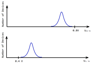

    It is important to interpret these input threshold levels from the statistical perspective. Here is a quick drawing for illustrating the behavior in general but not in accurate numbers:
    When rising the EN voltage from 0 to 0.8V then the EN threshold of all devices is following some statistical distribution. The majority of devices is detecting a high and enabling at let's say 0.7V. When reaching 0.8V the whole population of devices has detected a high with additional margin. So this would be the spec limit for VIH TH because we can be sure that all devices will be enabled at this voltage and above. That's also the reason why it is specified as a minimum voltage level. Once the devices are enabled then the hysteresis takes effect and the distribution for disabling is lower now. So when slowly lowering the EN voltage again, then the majority of devices is detecting a low and disabling at let's say 0.5V. But at 0.4V we can be sure that all devices have disabled with some margin. So this can be the spec limit for VIL TH as a maximum voltage (below they are disabled for sure). To be precise, these distributions also include variation for the specified temperature and VIN corners.
    If you pick a single device from the middle of the distribution, which would represent the majority of the population, then it would enable at 0.7V and above in this illustration and it would disable at 0.5V.and below. So the hysteresis would be 0.2V in this case. There is no undefined state in between.
