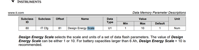

  • Hello Chad,
    Design energy is able to be scaled proportionally with "Design energy scale"
    Design Capacity can't be scaled with a parameter but are able to "scale" the design capability through the "calibration" tab in bqstudio where you can for example apply 2 amps and measure it as 1 amp thus applying a 2x scale within your design capacity.

    I don't have the access to EV2400 hence I can't take advantage of bqstudio.  I only have my MCU as the mean to read/write to BQ27426.
    so I assume from your suggestion, I have to set Subclass ID 80 with Offset 81 with the value of 10 first,
    then I can set the
    Design Capacity = 1000
    Design Energy = 3700
    Is it correct?
  • Hello Chad,
    We typically don't offer support with tools outside of bqstudio but if you "set Subclass ID 80 with Offset 81 with the value of 10" you would have what you attached above.
    Thank you,
    Alan

  • Hello Chad,
    Sorry for the miscommunication but my original message didn't sent but is attached below.
    "If you set your Design energy scale to 10 than you would keep the design capacity, terminate voltage and taper rate would stay the same and design energy would be divided by 10"
