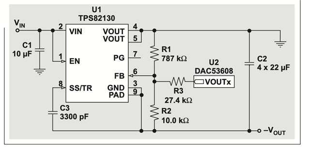

  • Hi Dino,
    thanks. If I understand it correctly, in both cases I would have to use the FB pin directly for setting the variable output voltage, correct?:
    Example from "Methods of output-voltage adjustment for DC/DC converters":
    Javier
  • Javier,
    Correct, this is a very simple feedback network to use to alter the VOUT voltage. My personal favorite method due to its simplicity.
