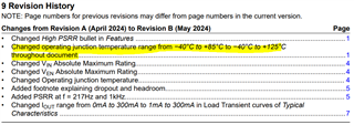

I have a question about the revised TLV773 datasheet.
The Tj range changed when it was updated from Rev.A to Rev.B.
Please tell me the reason behind this change.
Has the device changed?

Hey,
There was no change to the device, the device is specs are for 85 degrees. However, the device is operation at the higher junction temperature, and it was decided to promote that in the datasheet.
