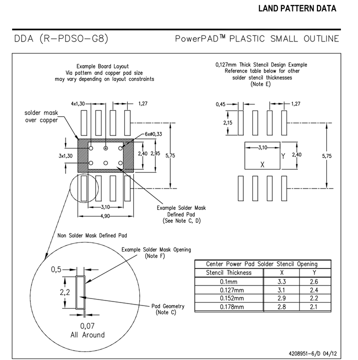

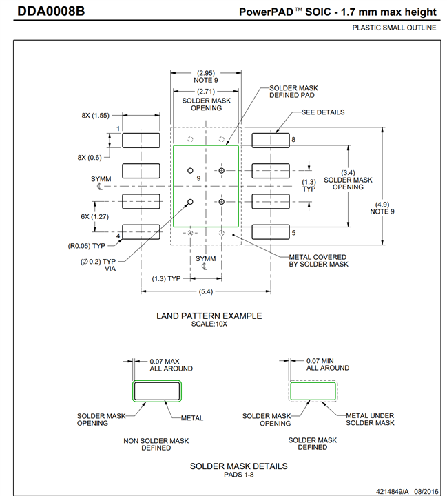

There're two land pattern on the d/s. which one is recommended? Why? thanks.
Hi Brian,
Recommend to follow DDA0008B dimensions for outline and land pattern.
Nitya
