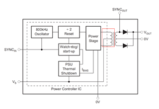

Power supply module DCP01 series,Will the change in the turns ratio of the primary and secondary coils caused by a partial inter-turn short circuit in the primary coil lead to an increase in the output voltage of the secondary coil?
No, a shorted interwinding turn on the primary will at best result in a decrease in the secondary winding volatge.
Steve
Output voltage could increase or decrease depending where the short occurs. Maybe check, how one sample compares to another and if a difference is observed then investigate how a shorted turn might have occurred (high voltage breakdown, moisture, wire varnish breakdown, etc).
