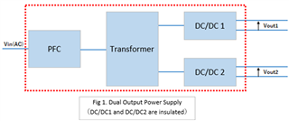

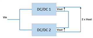

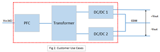

Hello support teams.
I would like to operate converters that use LM5145 in series.
Is series operation possible with LM5145?
I am concerned that if there is a difference in start-up times between the two converters, the overcurrent protection will be activated and one side will be unable to start up.
Please let me know if any countermeasures are necessary.
