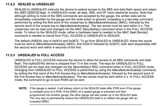

I am working with the BQ40Z50EVM-561 module. I wanted to reset the module in the commancds tab. i have instead sealed the device. how do i unsal it
Hi Manan,
If bqStudio is being used, the UNSEAL command, then the UNSEAL_FULL_ACCESS command can be sent to unseal the device.
If a different host is being used, please follow the directions below to unseal the device:
