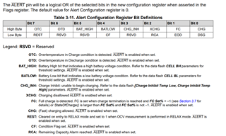

If alert signal is asserted, then how long the signal will be in low state?

Hello Saravanakumar,
The alert signal stays low till the alert is resolved.
specific register for clearing the alert
-You are able to set which register would get a alert signal based on the register bit table
The resolution is through I2C right
-The alert signal can be send through the SCL or HDQ communication line and will resolve when the Permanent failure event has been resolved.
