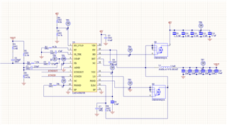

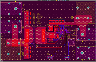

I am using LM5145 in my board as 40V regulator.
Input voltage is 48V.
When input 48V, the board is overheating and so LM5145 has been damaged.
I designed the circuit by using the LM5145_quickstart_calculator.
Please review my design and help me.
