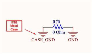

I am using the LM3671MF-3.3/NOPB in a circuit for my company as a 3.3V regulator. In this design we have a USB 2.0 connector that uses Type A USB. We have the casing of the USB connected directly to our digital ground (same ground that our LM3671MF-3.3/NOPB uses).
When I provide an electric shock to the USB casing, the 3.3V regulator gets damaged and no longer works. When I replace the 3.3V regulator with a new one the board operates as normal.
As you can see we have an ESD problem and it is affecting quite a few of our boards which results in unhappy customers. I have tried the typical solution of connecting a TVS diode directly across the input of the 3.3V regulator. This resulted in what seemed to be a more reliable solution, but still after shocking a few times the 3.3V regulator eventually fails. The tvs diode I used was the SP0502BAHTG. I tried both a unilateral and bilateral (by connecting 2 SP0502BAHTG's in series) connection for my TVS diode and it failed when shocking the USB case.

    If the spike you see in your application is longer it may be more than an ESD strike and this may cause the device to get damaged. My suggestion is to experiment with a damped input filter using a ferrite bead ( https://www.ti.com/lit/an/slvafe0/slvafe0.pdf ). Small case size cap with low ESL may also be useful with the filter to to provide a low impedance path for the spike. You can monitor the voltage at the input pin of LM3671 with the extra filter to see if it is below ABS max spec.
    In case the spike voltage can't be reduced below the ABS max rating of LM3671, then you may have to consider an alternate device with a higher ABS max rating.

    Since we do not have any ESD simulating hardware, the way that I am shocking the USB case is with a barbeque grill ignitor / shocker and its possible that the shock could be a longer duration than a typical ESD strike. I could attempt to add a ferrite bead with a low ESL cap to see if that makes a difference.

    When adding the ferrite you might also have to add an extra damping cap (Cd with Rd) as the inductance of the ferrite along with the 4.7uF (C6) in your schematic can form an undamped LC.
