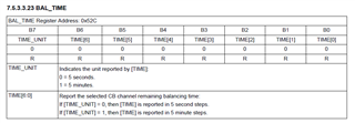

    As you said. Through the above operations, I achieved voltage and equalization in a time-sharing manner. However, I have a new question. The voltage acquisition cycle is set to 100ms for each acquisition. After each acquisition, the equalization is turned on, and the equalization time is set to 30 seconds. During actual testing, when the 30-second period ends, the equalization is still running. When reading the remaining equalization time of the corresponding channel, it is found that the remaining equalization time is still the set 30 seconds. Is this phenomenon correct? If it is correct, what is the cause? Is it because frequent pauses and restarts prevent the counter from updating?

    The BAL_TIME only has a resolution of 5s or 5min. Perhaps not enough time has passed for it to be updated.
    Also remember only 1 channel balancing time can be read at a time.
    Make sure you are reading a channel that is actively balancing.
