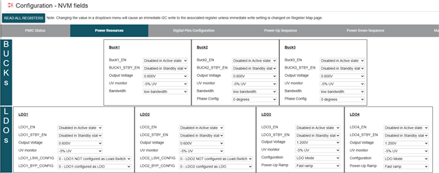

1. How the BUCKs and LDOs are configured. Which tool to be used for Configuring.
2. Can the Buck and LDO be software configurable through I2C. Like by default It should be particular voltage for example(1V), Then After can I configure using I2C to 3V. is that feature Available.

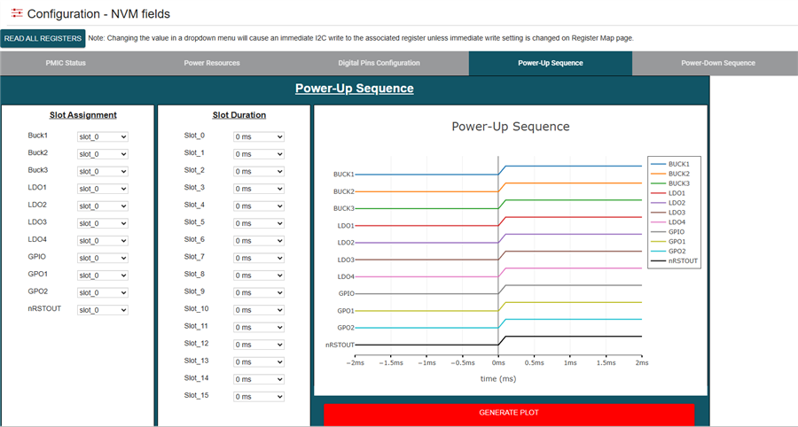

3. How the BUCKs and LDOs Power sequencing Can be Configured. Is pre program Supported. how to Program and What tool to be used for Pre Programming ?

    1. BUCK and LDO settings can be configured using the TPS65219_GUI tool. This is used for both the TPS65219x and TPS65220x family.
    Settings can be configured directly in the respective register or by using the Power Resources section in the Configuration-NVM Fields tab:
    2. Yes. After configuring settings using I2C, the steps for "NVM Programming" can be followed to overwrite the desired settings to the device, to make your settings the new default value upon power up.
    3. The TPS65219EVM-SKT (5x5) can be used to program the TPS6522005-EP chip before installing onto your board, with the TPS65219_GUI mentioned earlier.
    Settings can be configured directly in the respective registers or by using the Power Sequence sections in the Configuration-NVM Fields tab:
    The TPS65219 NVM Programming Guide provides details on this process, which is the same for TPS65219x and TPS65220x devices
