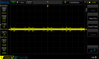

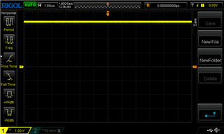

    1) SW - 28V IN, 28.8V OUT
    2) VOUT AC - 28V IN, 28.8V OUT
    3) VIN AC (IC input pin) - 28V IN, 28.8V OUT
    4) SS DC - 28V IN, 28.8V OUT
    5) SS AC - 28V IN, 28.8V OUT
    Here the noise is due to probe wire, is not on that pin, is a background noise
  • Hi Marco,
    Thank you for sharing the waveforms. Vout shows a ~70mVpkpk of AC ripple, this means a ripple of 0.07/28=0.25% which is pretty low and acceptable. SW, VIN and SS waveforms look good too. Are these waveforms with 100nF? The small variations on Vout (I guess that is what you mean with 10mV drifts) are probably coming from the HF harmonics from leakage inductance when the MOSFET turns off, but it shall not affect regulation and switching.
