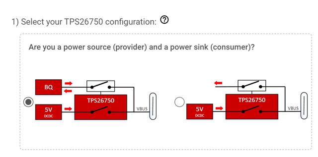

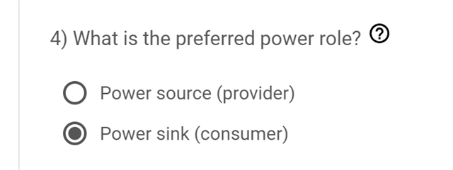

    Here's my config:
      "questionnaire": {
        "device": "TPS26750",
        "toolBuildVersion": "1.0.2",
        "answers": [
          null,
          0,
          7,
          7,
          1,
          3,
          3,
          0,
          null,
          1,
          1,
          3,
          0,
          0,
          1.536,
          5,
          2,
          2,
          0

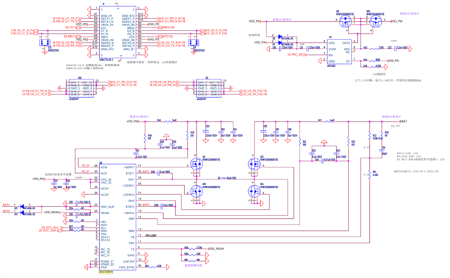

  • Hi Zhiyuan,
    Please understand this is a public forum, so anyone with a ti.com account can view your schematics.
    Could you send me the full USB-C schematics including the BQ25756, TPS26750, TPS4S480, and USB-C connector? We can set up a private message if you are concerned about sharing on the public forum.
    When you connect the USB-C flash drive, do you see any voltage on VBUS?
    Could you measure the CC1 and 2 pins, and VBUS on connect using an oscilloscope and share the capture?
    Are you loading the full flash binary to an EEPROM or are you loading the image over I2C?
    Does the TPS26750 have power?
