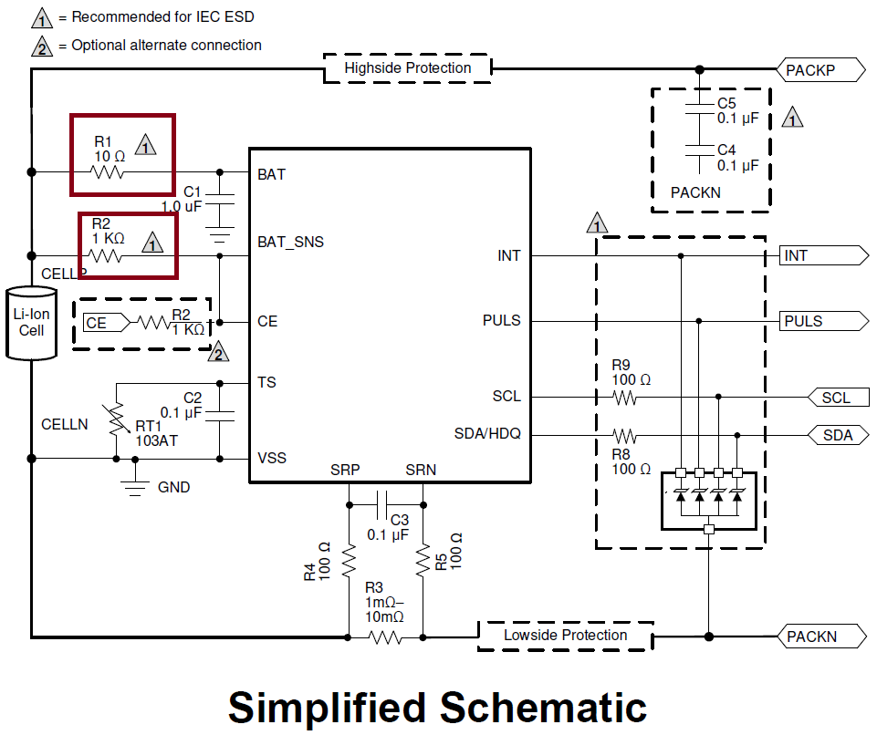

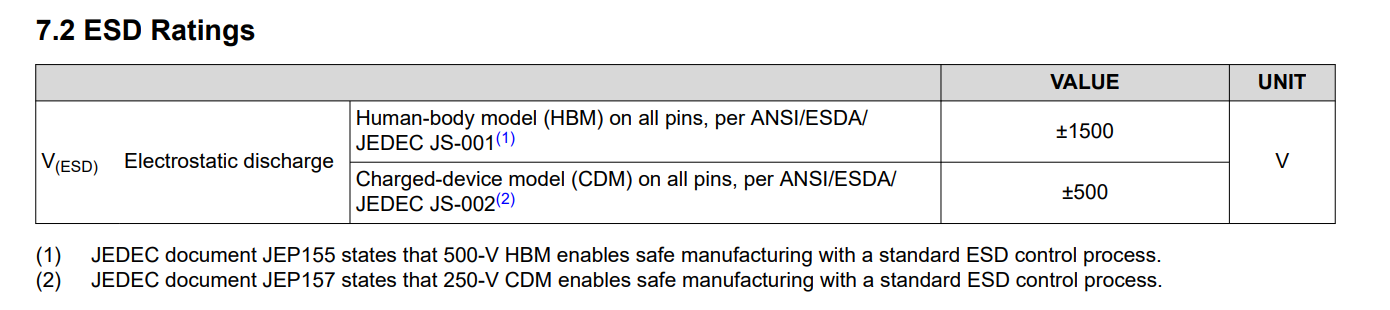

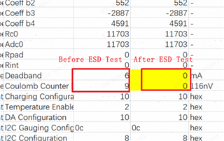

When using the BQ27Z561, I performed ESD tests on the battery (8kV contact discharge and 15kV air discharge). After testing, the fuel gauge lifetime data became highly abnormal. Is this expected behavior? If not, what are the possible solutions?
8KP_.gg.csv
