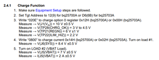

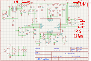

Hello, can you please help me with this BQ25703A charger chip?
I am trying to get it working, but I can't read any of the voltage or current values.
here is my arduino source code, I'm using this library to read/write the registers: https://github.com/Lawmate/BQ25703A/tree/master

This code is basically the readVoltages example from the library
Here is the output of the serial console:
System Booting Up...
I2C Initialized with SDA: 1, SCL: 0
Scanning I2C bus...
Scanning...
I2C device found at address 0x27  !  -> PCF IO Expander
I2C device found at address 0x28  !  -> USB_PD
I2C device found at address 0x40  !  -> INA3221 ADC
I2C device found at address 0x6B  !  -> Charger
I2C device found at address 0x75  !  -> Buck converter
done
Initializing STUSB4500...
Connected to STUSB4500!
STUSB4500: Set to request 9V if possible
Voltage of VBUS: 3200mV
System power usage: 0.00W
Voltage of VBAT: 2880mV
Voltage of VSYS: 2880mV
Charging current: 0mA
Voltage of VSYS: 0mA
Anyone knows what's the problem? Could it be a hardware issue? The chip is detected correctly by the I2C scanner so it should be working. There is 5V on the VBUS input, but the ADC isnt reading anything
