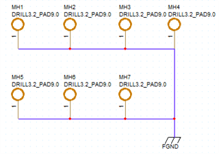

    What is FGND connected to?
    Additionally, is there an electrolytic on input? An under-damped filter on input can cause damage to any buck converter, as the inductive ring from the input filter can cause out of spec operation. Please see this application note for more details: www.ti.com/.../snva489c.pdf
    Thank you,
    Joshua Austria
  • Hi Joshua,
    As shown below, FGND is connected to the screw hole and is also connected to GND via BEAD.
    There is no electrolytic capacitor on input, and the input circuit shared above is all there is.
    JH
  • Hi JH,
    Thanks for noting FGND.
    I see, the capacitors on GND and input connected to FGND through a ferrite bead and a capacitor do cause some concern for me.
    Is this meant as some sort of common mode filter? Is this for isolation? In either case, this part was not designed to have a ferrite bead connection between input and ground.
    My recommendation would be to remove these capacitors and to add the electrolytic on input as this is a critical component for any filter on input. Then check if the customer is still experiencing the input impedance issue as before.
    Thank you,
    Joshua Austria
  • Hi Joshua,
    As you mentioned, are the capacitors to be removed the ones shown below?
    CH PARK
    Yes, those were the capacitors I was concerned about that connected a ferrite bead between input and ground together.
    Thank you,
    Joshua Austria
