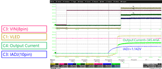

The TPS92515 has a power on calibration.
Does this calibration take place during the non-switching period immediately after the input voltage has reached the operating range?
Or is calibration performed after a voltage is applied to IADJ?
In the waveform below, the output current rises about 500 ms after a voltage is applied to IADJ.
If so, what is the maximum time that calibration takes?

  • Hello Kaji,
    Calibration is done immediately at power on reset (POR).  It measures the offset voltage and stores that value in the logic block.  That stored value is used to adjust the output current setpoint.  If the offset voltage is on the border between two calibration setpoints, then when doing power cycling you might toggle between two off set voltage settings.  We know that as the VIADJ is larger that error due to offset voltage will be a less significant percentage of the signal.  As VIADJ goes down then Voffset starts to become a larger % of the signal and thus the percent error gets worse.  This is a common issue when using any amplifier or comparator.  If you don't want to use this feature then you can use the TPS92515A, which has this feature disabled.  This device still meets the datasheet specifications either way.
    -fhoude
  • Thank you for your reply.
    I understand that calibration is performed immediately after POR, but the customer applies VIN and then applies VIADJ a while later.
    In this case, is calibration performed based on 2.4V as the reference?
    Or is calibration performed again when VIADJ is applied?
  • Calibration is done after POR and only once.  That calibration stores offset voltage and is stored as longs as Vin/Vcc stay on.
