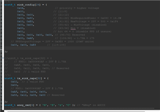

I have been using TPS25721, BQ25756E, and STM32. My task is to re-negotiate TPS2751 using stm32, I tried to using the register Autonegotiate Sink Registe (0x37), Transmit Sink Capabilities Register, and Command Register for I2C1 (Offset = 8h) [Reset = 00000000h] but I can not re-negotiate my tps. The following code:

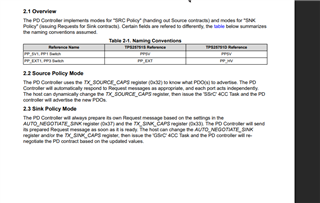

  • Yeah, my TPS is in an active PD contract my tps is as a sink, and I want to renegotiate the Type-C/PD contract to show Welcome again. I read the datasheet and I found that I can renegotiate by setting the AUTO_NEGOTIATE_SINK register (0x37) and the TX_SINK_CAPS register (0x33).

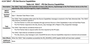

    After updating the contents of the Transmit Sink Capabilities register, the Host should send a "GSrC" 4CC command in order for the PD controller to issue a Get Source Capabilities message to its port partner which will allow the Sink to send a new Request message with its updated capabilities.
    Are you looking to also update the Autonegotiate Register 0x37? This requires a different 4CC command that is not currently described in the TRM.
