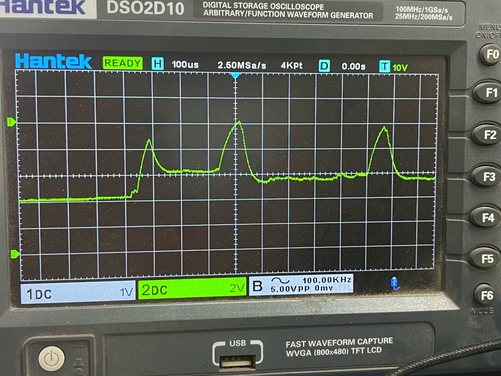

    Only the DSG fets, yes. Like i've mentioned on the previous thread, it works fine at first, then i lose gate drive and the FETs burn out. I tested almost 6 boards and observed this on all 6. I've attached a scope image on the previous thread for DSG fet Vgs after i lose drive. And i never get them to work again. I tried replacing the BQ76930 on one board and observed the same thing.

    4. This is the Vgs of my DSG fet after a few mins of turn on as mentioned on the previous thread (https://e2e.ti.com/support/power-management-group/power-management/f/power-management-forum/1500824/bq76930-dsg-fet-burnout-and-1v-gate-drive)
    No it does not go below GND ever.
    (Fet VGS scope data after i lose gate drive):
    This is the turn-on VGS signal for DSG fet when the IC was giving me a good gate drive signal for about a min during turn on (the first time i turn the fet on for every board i tested):
    5. Yes i tried using both these fets and the results were same:
     a) BSC028N06NS
     b) AON6144
    6. As far as i 've cheked, none of the voltages ever went above the ABS_MAX rating of any components. If that was the case, then the board should not function even now right? Even after i end up losing the DSG drive from the BQ76930, rest of the functions of the BMS work just fine. I even charged a battery after desoldering the DSG fets from the board.

    I'm more interested on transient test and the negative side of VC5B, VC5, VC6, VC1, VC0 respect to VSS and VC5x. I want to see if any of this signals go below the abs min. Can you re-connect a scope on VC5B, VC5x, VC5 and VC1 and use the 6s configuration and see if there might be a case where the abs max/min is being violated. I think low battery voltage would exaggerate any fails, so if you can try with a 6s configuration, and cell valid but with lower voltages, and re-capture that'll be very good. Keep in mind, on the EVM we don't see this issue, so seems to be very particular to your system, so my best guess is some signal is dying after a few minutes of use and creating additional transients that eventually damage the FET.

    As suggested, i changed the configuration to a 6S pack (battery voltage at about 20V) and yes we are using actual cells to test this.
    I observed the following when doing this:
    The VC5X on the board i was testing was at about 10V initially and on two of my boards, i did get a gate drive of about 7V. Your doubt was right, after a few minutes of turn on (pluggin in the cell connector), the VC5X signal falls down to 0V w.r.t GND and this is when i lose my DSG drive voltage. I checked all of my boards again and on 2 boards this observation is the same and on the other boards, right when i plug in my cell connector i observe 0V on VC5X and i never get gate drive on these boards.
