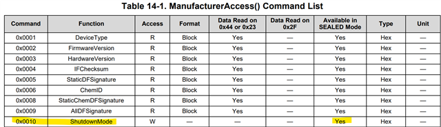

    • What is condition of reset which leads to mode change of SEALED/UNSEALED/FULL ACCESS?
      (e.g. when power supply is stopped for BAT/VCC?, when sending reset command?)
    • 0x0035 SecurityKeys of ManufacturerBlockAccess seems that both UNSEALED and FULL ACCESS can read/write.
      Is this command can be executed in UNSEALED mode?
      If so, there is no difference for accessible range between UNSEALED/FULL ACCESS and the device reduces risk for unintended firmware change with additional step to transition to ROM mode. Is this understanding correct?
    • What is command to access data flash?
      ―SBS command = Normal access to registers at addresses other than 0x00/44?
      ―Manufacturer(Block)Access = Access to extended registers at 0xXXXX using addresses 0x00 or 0x44
      ―Access to Data Flash = ????????????????
    Resets will send the gauge back to SEALED.

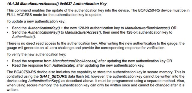

    I believe this should only be accessible in FULL ACCESS, but I will check to confirm.
    I believe the full firmware (.srec file) can only be programmed in FULL ACCESS.
    ManufacturerAccess() allows for access to all of the data flash.

  • Hi Shota,
    Sorry for the delay. After testing, I do not believe the Security keys can be changed in unsealed mode, only unsealed full access.
    Same thing for the programming of the .srec, this was only available in unsealed full access.

    5.~6.
    14.1.34 ManufacturerAccess() 0x0037 Authentication Key
    The bq40z50-R2 device also includes the capability to store the authentication key in secure memory.

    When authentication key is written to data flash using AuthenticationKey(0x0037) or Authenticate()(0x2F) command, authentication key can be read.
    While, if authentication key is written using BQKEYPACKAGER, it cannot be read.
    16.1.35 in Technical Reference Manual states "There is no direct read access to the authentication key".
    Could you elaborate what method can/cannot prevent read of authentication key?

    I believe these commands can only be used in FULL Access
    0x0010(ShutdownMode) command can be used in SEALED mode as well according to Table 14-1. ManufacturerAccess() Command List.
    Regarding two-words of Unsealed Key/Full Access Key, is it necessary to use different value from ManufactureAccess() Command?
    The main difference between writing the key via BQKEYPACKAGER and AuthenticationKey() is the amount of times it can be programmed. With AuthenticationKey() this can be done multiple times since it is stored in the data flash. With BQKEYPACKAGER, this can only be written once.
    For both, it cannot be read back out, however the Response can be used to verify the value of it.
    Please avoid setting these as the same values as the other commands.
