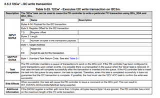

    • Sadly I can not log I2C communication on I2Cc bus. But I can access BQ25756 with I2Cr and I2Cw 4CC-Commands.

    - I read/write charger registers with I2Cr & I2Cw. With I2Cw I experienced a deviation from manual. If I want to send 0xdc to register 0x17 of the charger from manual I would place 0x6B 0x01 0x00 0x17 0xDC into the TPS data register. Doing so I see the TPS sending 0x6B(W) 0x00 17. I think length must be only one byte and register offset is included in payload. By putting 0x6B 0x02 0x17 0xDC into TPS data register I managed to save 0xdc into register 0x17. The I2Cw command always ACK even when no I2C message is leaving TPS.
    Yes, you are correct here, there is a typo in the TRM we are working on fixing. See below for the correct formatting.
