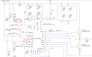

1.The reference design of resistance R6942 uses 0.24R, but we can use 1R here,Is that OK?
2.Whether the interior of PIN23 is connected to GND?

Hi Liulu,
1. Need to follow the reference design closely for this as this is part of the compensation loop for the EMI filter. Don't use other values that the ones in the reference design.
2. Pin 23 is connected to the active EMI sense input.
Dino
