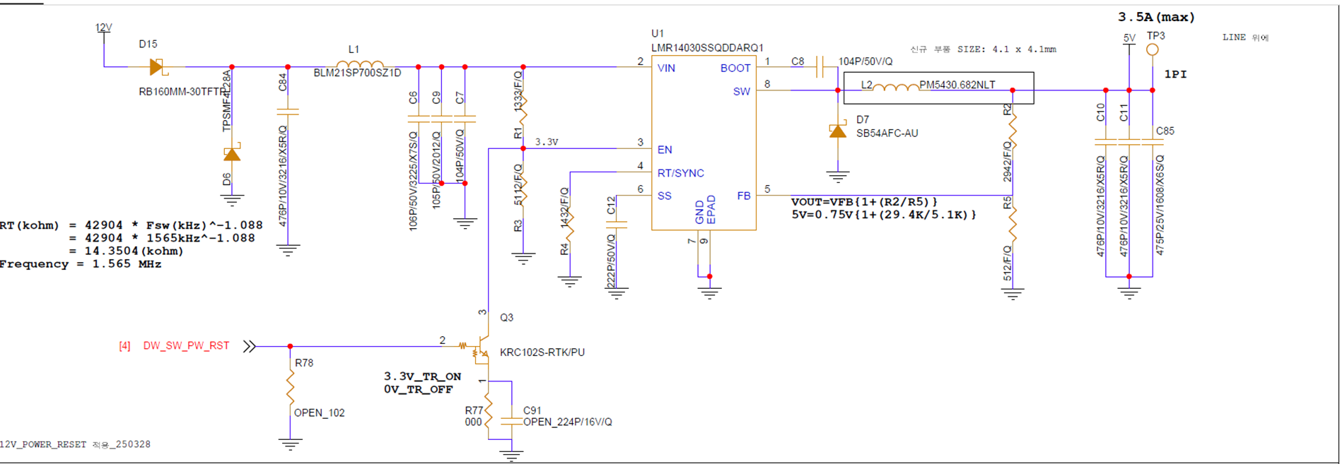

LMR14030-Q1: Question about output capacitor
Part Number: LMR14030-Q1
Dear TI experts,
My customer have a question about designing LMR14030SSQSSARQ1.
They do not have enough PCB space, so they want to know ceramic capacitor in the output.
Please check the schematic first.
Input voltage is 12V, output voltage is 5V, output current is about 150mA.
And they want to change C10, C11 capacitors to 22uF 10V X7R K 3216 Q x 2.
Could you confirm that this change would be okay or not?
Please check this issue. Thanks.
