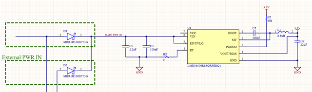

LMR36506-Q1: .38V output.
Part Number: LMR36506-Q1
Looking for some assistance here.  Wanted to use this little switching regulator: lmr36506RS3QRPERQ1
Power in is 12V(~11.8 after schotky).  I have verified that 11.8V is seen at both VIN (p4) and EN/UVLO(p3).  They are tied together on the PCB.  I am measuring about 380-400mV at the output.  Tried this circuit on two pcb's now with the same result.
The output voltage is very close to the threshold for the enable pin, which makes me wonder I have an issue with the circuit I haven't noticed yet.
Thank you for any assistance you can provide!
