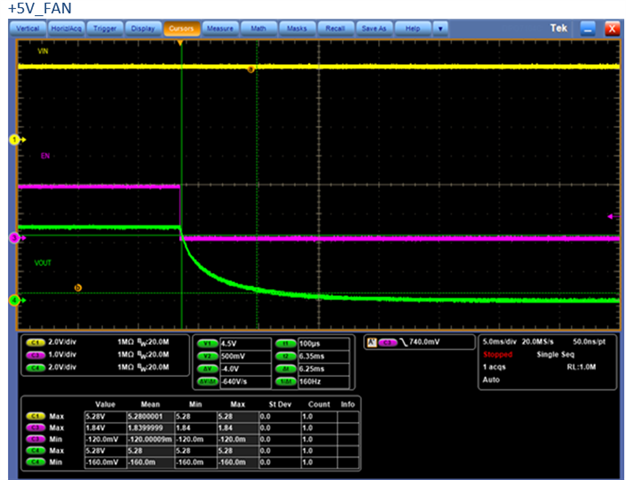

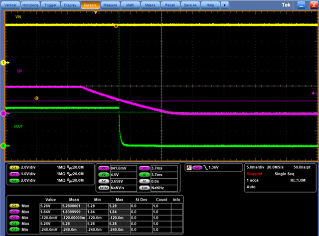

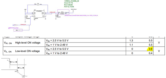

Hi Team
Since we need to measure the LSW T-off time, but we find the Vout(+VREG_CONN_IN=5V) is fall when enable is about 0.85V in our application,
It’s not mapping the datasheet VIL value 0.6V
Normal behavior for other rail application, only occur Vout fall>En VIL on this rail
abnormal waveform:

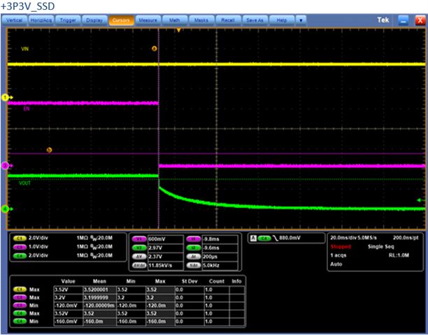

Normal waveform:
I think it would relate to EN falling rate. do you think it's normal to influence the trigger point?
