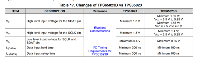

  • Hi Daniel,
    Thanks for the info.
    One thing to note is that TPS65023 has a relatively longer minimum setup and hold time requirement for I2C (this was improved in TPS65023B)
    Are these parameter lower for your other devices on the bus? This may be the reason for a discrepancy.
    Best Regards ,
    Sarah
