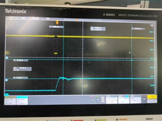

The customer's product is an e-book, and they use LM3630A as the backlight driver.There is a problem now and I would like to ask TI for help.
3630A restarts with the front light turned on, there is a probability that the front light will not light up after restarting. Reset(Adjust the brightness of the lower light, or turn on and off the lower light) the front light brightness to normal.
Equivalent to calling this,
The customer suspects that it is caused by OVP, but according to the datasheet, OVP will self recover.
So they tested the waveform,

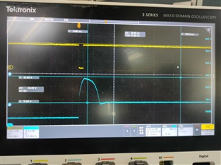

Blue is the OVP pin of the chip and the positive pole of the lamp. The yellow is the interrupt pin of the chip, and the OVP pin did not have such a large overshoot when the first light was turned on during restart,
Turn off the light and then turn it back on, there will be a 37V overshoot.

    The customer has confirmed that it may be a problem with the driver. The 0x00 register was not set during initialization, which may result in being set in sleep mode, i2c_smbus_write_byte_data(LM3630Aclient, REG_CTRL, 0x06); //cold,
    Only when setting the brightness, set the 0x06 register.. Is there a need for a delay at this point? Without a delay, they checked and found out that REG_SRT_S is not updating.So they modified i2c_stmbus_frite_byte_data (LM3630AClient, REG_CTRL, 0x06); //Cold arrived early for the probe.
