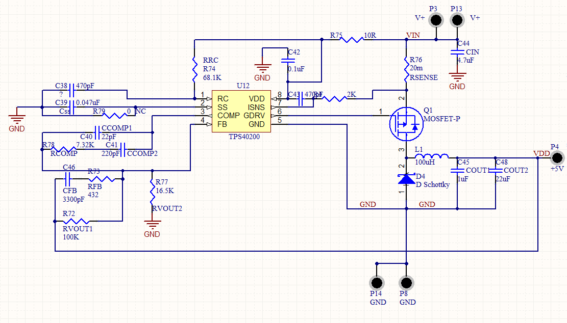

I have built and tested a 5.0V supply with the TPS40200-HT chip based on the SwitcherPro schematic and layout.
I originally built this supply for a 500mA max supply.  It is currently being used on a system that draws 40mA (tested on an external power supply).
Here is where the issue arrises:
My supply will provide 5V, but as soon as the load (40mA system above) is connected, my supply voltage drops to 1.2V.
Can you please provide some assistance with this issue?
