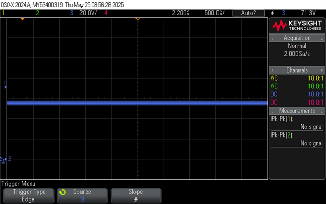

    Here is VDD to VSS with 100ms/div.  Its a pretty stable 55V DC.  The 500ms scale looks the same.

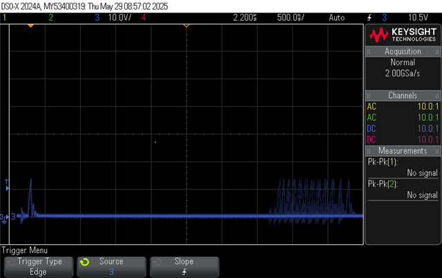

    I've also scoped some of the other signals on a "bad" board, here is DRAIN to PGND:

    Thanks for your waveform. Looks like it is not a handshake issue since we can see there are some switching waveform even on the bad board. It may be an issue of the DC/DC:
    The SRF resistor (R426) is only 10-Ohm, which is low for TPS23758's integrated MOSFET. The 2nd side sync FET (Q400) and Zener diode (D302) are either 30V or 24V. No snubber RC to reduce Q400's overshoot. When switching speed is fast as R426 is only 10-Ohm, there could be higher overshoot at Q400 and D302, which could cause Zener diode avalanche every switching cycle and degraded fast.

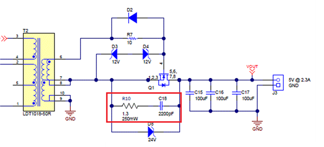

    Do you recommend adding a snubber RC to reduce Q400 overshoot?  Are R10 and C18 from the eval kit is an example of what you're referring to?

    Yes snubber RC is recommended and you can use the EVM values as the initial values to test.

    Q400 is the sync FET on the flyback secondary side. When primary FET inside TPS23758 turns on, and Q400 turns off, the Q400's Vds(off) could be Vout + Vin/Npri*Nsec + overshoot. The overall values could exceed the 30V rating. Overshoot mainly comes from transformer leakage inductance and stray inductance.  Adding series RC snubber can help to reduce the overshoot: smaller R + higher C for smaller overshoot but higher switching loss as a trade off. You can start with the EVM values to test.

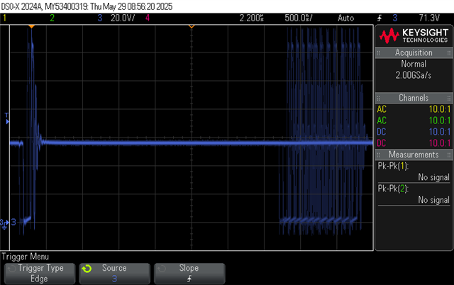

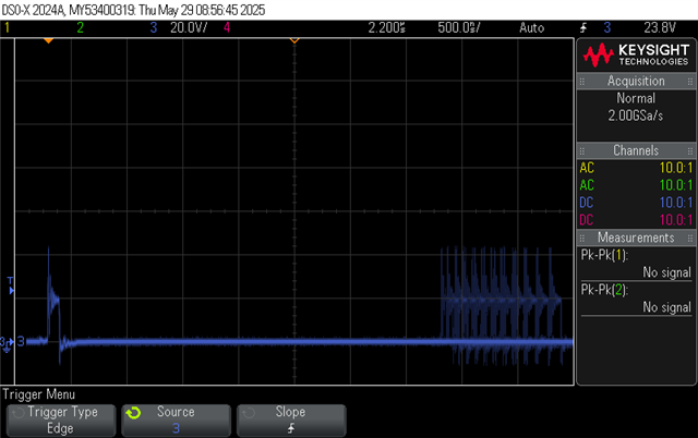

    Got it, thank you.  I was able to scope Vds for three configurations: no snubber, EVM snubber and 2.6 ohm EVM snubber.  I like the look of the 2.6 ohm snubber circuit because it reduces the overshoot by 6 volts and that in conjunction with a higher voltage MOSFET should be much more resilient.
    I will be changing to a 60V MOSFET and a 51V Zener with a 50 ohm SRF.
