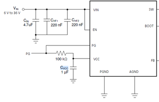

Part Number: LM60430-Q1
Cvcc is specified as 1uF value in the typical application, but the characteristics of MLCC are not specified. Please check if there is any problem using it as the characteristics of X7S.
GCM155C71A105KE38D is being applied. (1uF/1005/10VDC)
  • Hello Minikyu
    As we discussed on earlier thread, it should be okay as long you consider variations with temperature and DC bias. Additionally, I would recommend increasing voltage to 16V or higher
    Thank you
    Onkar Bhakare
