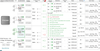

TPS23881: TOVLD is occured, but Pcut is notoccured. Why
Part Number: TPS23881
  • Hi Yao,
    Based on the picture, below could be the potential causes
    1. The tolvd fault does not happened in this power on cycle. It could be a fault in pervious test and you can erase this fault by clicking the brush
    2. The tovld fault happened in this power on cycle, but 4P PCUT is disabled (4PPCTxx = 0 in 0x2D)
    3. The tovld fault happened in this power on cycle. Single channel (2-pairs) may exceed Pcut but Summed 2-channels (4-pairs) may not.
