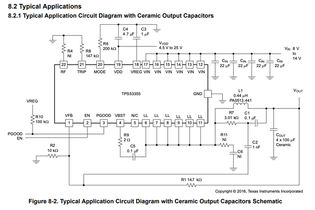

Let's take a look at the application schematic:
Specifically, let me call your attention to C1, C2, R7. These components are referred to as the ripple injector, and are recommended in the datasheet if you have low ESR MLCCs on the output. I have placed these components, and am getting relatively good control loop stability up to 20A, but I am seeing more ripple than I'd like at the output (about 100 mV pp on this 1.2V rail), and I can't help but think that C1 is partially to blame. R7 and C1 together form a path with impedance 3kΩ + 10MΩ/jω from LL directly to VOUT, which seems ill-advised, and I assume is partially responsible (although I haven't tried desoldering C1 yet, as I don't have very many boards to spare).
Can you folks chime in on the purpose of C1 specifically? I understand how R7 and C2 together increase the ripple on VFB, but I'm not understanding the purpose of C1. Is C1 just about transient response, and giving a faster path from VOUT back into VFB? If so, can I omit C1 if I'd like to trade off worse transient response for less ripple and more control loop stability?

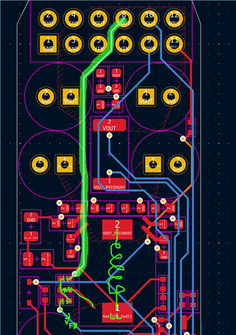

  • Got it, thanks for the info. Based on reading that document, it sounds like C1 (called C_A in that document) is not just about transient response, and actually is about producing an appropriate ripple? So I guess I shouldn't be removing C1? Note that I assumed it was about transient response, so I hooked up C1 to the output all the way at the very end, after all of the bypass caps. Here you can see the little RCC network highlighted in green, and that long highlighted trace is me hooking up C1 to VOUT at the very edge of the board. I assume this is pretty bad, and C1 should be connected directly to inductor's output?
