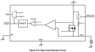

  • Hi Leo,
    For off-state open-load detection - fault goes low and the SNS pin will read VSNSFH so ~3.3V would make sense here. Can you please completely turn off the TPS1HTC30-Q1 device or remove it and measure the input/output pin voltage to see if something else in the system is causing an offset? A slight voltage offset could also possibly be due to leakage from diagnostics. If you turn DIAG_EN and EN are off, you should see 0V on the output. Can you please confirm this and also that there is not a general offset due to the measuring equipment being used? Do you have any waveforms that we can take a look at?
    Also, we typically recommend 10k for the fault pull-up resistor.

    Thanks for your reply.  I agree that a non-zero voltage at VOUT is expected with DIAG_EN high due to the open-load detection, however that should never be higher than the VS voltage based on the block diagram.  Nothing else in my circuit touches that output net, and there are no voltages higher than VS elsewhere in my design either, which strongly suggests the IC is misbehaving somehow, most likely something to do with the charge pump for the gate driver.
    I will need to rework the PCB and lift a pin to disable DIAG_EN, so I haven't tried that yet, but it's on my list.

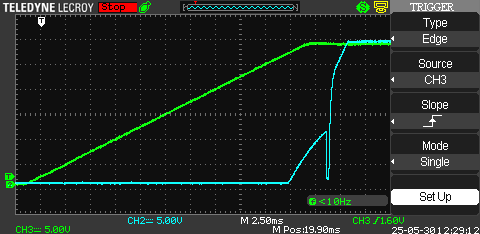

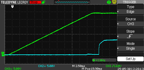

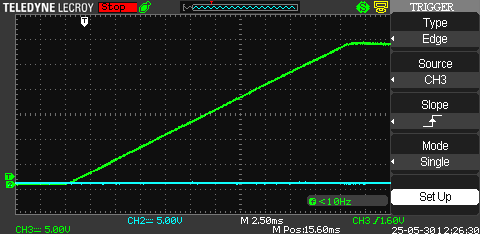

    I captured the voltages during startup at VS and VOUT with various loads as well.  Green trace is VS, blue trace is VOUT.
    With 22Ω load:
    With 100k load:
    With no load:
    The first two waveforms look as expected given DIAG_EN being high and turning on the internal pull-up for open circuit detect.  In the no load waveform, something odd clearly happens during turn-on, and the voltage ends up settling at the VS + ~340 mV value and holding steady there.  Whatever is going on though isn't purely related to startup conditions, as I was able to produce faulty and normal behavior simply by changing the load connected, I did not turn the power supply off between measurements in my earlier table.

    I apologize for the delay. I was able to discuss this with the design team. The reason for what we are seeing is that there is some circuitry between the charge pump and the VOUT rail which is enabled due to DIAG_EN being high. So, there is some IQ being dumped on the output pin. Some of the blocks are sourcing more than sinking which is why the output voltage potential is slightly higher than the input. Again, this should not be an issue with normal operation of device.
    Sorry for the confusion and I hope this helps provide more clarity on your observations. Thank you for your patience!

    Open-load fault reporting is part of the diagnostics features. An off-state open load condition is a fault state which is reported on the SNS and fault pins. In the on-state, the user has to observe if there is an open-load condition and it will not be reported.
    Leakage is measured on the VS to VOUT path when EN is off; there is going to be some leakage present due to the internal logic control path. The leakage by diagnostics is caused when this switch controlled by DIAG_EN is on. This leakage is known and is not faulty behavior as it does not affect device functionality or cause other issues.
    I measured the current at the ground pin and the highest current I saw was ~2mA when EN is low. I saw ~1mA when EN is high.
    Rishika Patel
