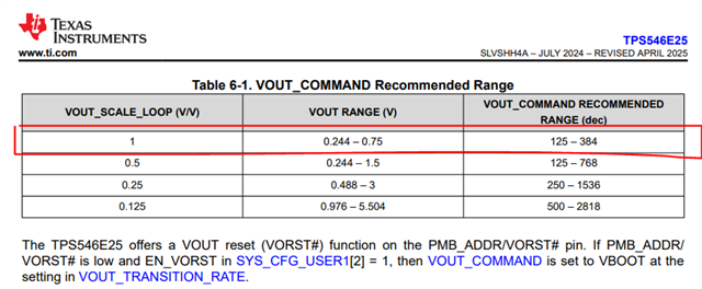

From the datasheet, VOUT_SCALE_LOOP can be set to 1, VOUT range supported is 0.244V to 0.75V.
Is this meaning this IC actually can support minimum VOUT = 0.25V instead of 0.4V which mentioned in the first page of the datasheet?
I need a design which can support VOUT = 0.25V, IOUT = 200A.
If this IC can support 0.25V at 50A per phase, I can use 4 phase to achieve 200A.
  • From the datasheet, VOUT_SCALE_LOOP can be set to 1, VOUT range supported is 0.244V to 0.75V.
    Yes.
    While the output voltage can be programmed through PMBus down to 0.244V, the minimum VBOOT_OFFSET1 voltage is 0.3V and the output voltage automatically returns to VBOOT_OFFSET_1 after a Fault, or when the output is disabled, so supporting a 0.25V application would require VOUT_COMMAND to be written to before the output is enabled each time, including after a fault and before restart if the fault response is programmed for hiccup restart.
    Yes, a 4-phase configuration using 4 TPS546E25 devices can support upto 200A.  See the restrictions above for supporting 0.25V
    While only rated for 40A / phase, you might want to look at the TPS546D24S to support a 0.25V output.  While the pin-programming does not support 0.25V, its VOUT_COMMAND offers NVM backup so that the output voltage will return to 0.25V during power-on by programming VOUT_COMMAND to 0.25V and clearing the VOUT bit of PIN_DETECT_OVERRIDE.
