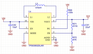

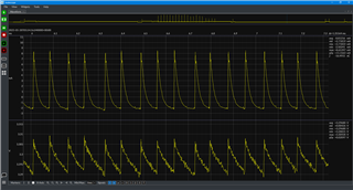

Hi, I am using the TPS63802 to supply 3.3V to a Wi-Fi module. When the Wi-Fi module is in a low power mode, it consumes very little in the order of tens of microamps. When measuring this with an energy analyser however (JS220), I notice I get different results if I use the TPS63802 to supply it, compared to a lab bench power supply. Debugging this further, I measured negative current spikes when using the TPS63802 which I believe correspond to the regulator switching.
I also get the same results using the TPS63802EVM, so I am confident my layout and components chosen are not the cause, but this is my schematic to show how it is configured when I see these spikes.
I believe it is something to do with PFM mode, as when I change MODE to high when using the TPS63802EVM the spikes go away and I measure the same power consumption of the Wi-Fi module as when I use a lab bench power supply. My suspicion is the energy stored in the inductor and output capacitor is too much, and there is too little load to absorb the excess energy which causes it to momentarily flow back into the regulator. Does this sound plausible, and is this expected to begin with? I also see the negative spikes increase to become even more negative if the load is increased.

  • Hi Brigitte, I measure at the output of the regulator. The net "3V3" in the schematic above connects to a jumper which then supplies the Wi-Fi module. This jumper is removed, and the energy analyser is placed across this.

  • Hi  Jonathan,
    From my understanding ,  load characters of  power analysis should close to electronic load, a capacitance load with low bandwidth.
    Then, it is not able to response the frequency of vout ripple in PFM mode, which means it will cause an instable Iout as you observed. Once you change your operation mode to FPWM. The vout ripple gone, i mean compared with ripple PFM mode, it is small enough to ignore.
    Also,  A lc oscillation may exist between your output cap, output cable and power analysis, then a negative current is makes sense too.
    I think it is a normal behavior but not issue.
    Tao
  • Thanks Tao for your reply. Can I please clarify your response. Are you saying the measurement system (the Joulescope in this case), is acting as a capacitive load with limited bandwidth? And this load is unable to respond to the vout ripple in PFM mode? Could you please expand on this part? I am unclear how this causes an unstable Iout. Are you saying the Vout ripple is to fast for the Joulescope to capture properly?

    I was referring to the 470nH power inductor.
