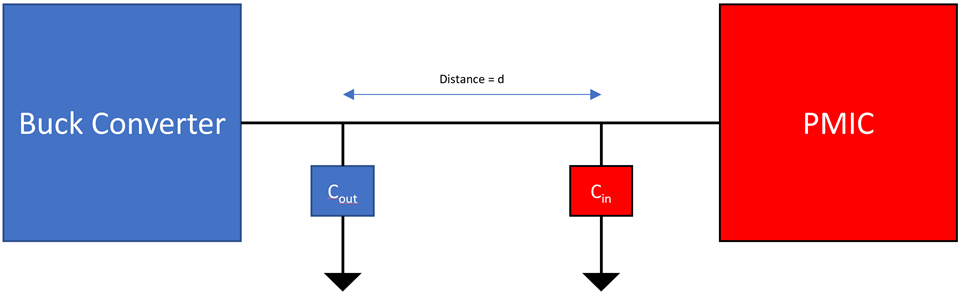

    The output of this regulator is used as the input to a PMIC (LP87524J), and there are four 10uF capacitors connected in parallel at the PMIC input.
    Would it be possible for these PMIC input capacitors to compensate for the insufficient output capacitance of the LM60430-Q1?
    If layout distance is a critical factor, could you advise how close the regulator output and the PMIC input should be placed (in millimeters)?
    Looking forward to your response.
    Thank you.

    if I understand correctly,
    You are asking if the Buck and PMIC in the above picture are close enough - can you consider the input cap of the PMIC as part of the output capacitance of the buck? Right?
    Taru
  • Yes, that's correct. I'm asking how close the Buck and the PMIC need to be in order for the input capacitors of the PMIC to be considered as part of the output capacitance of the Buck regulator.
  • Hi Donghyun,
    Theoretically speaking - this can work.
    However, it is very difficult to say if this will work in practice. It depends on your PCB routing and power delivery network - this will require you to model your PCB parasitic inductance and capacitance - which will determine how your transfer function will look like and if the PMIC input capacitance can 'add' to the DC/DC output capacitance.
    You can check if the load transient response is according to your expectations - If yes, you can go ahead with the current implementation as well.
    The best way here is to place 2x 100uF as suggested earlier which should take up almost the same amount of space as 2x 22uF.
