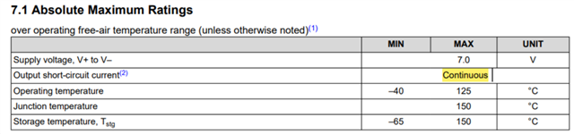

  • And what's this 'continuous' meaning? Is it meaning even shorted to GND at output, the device is in no risk of damaged?

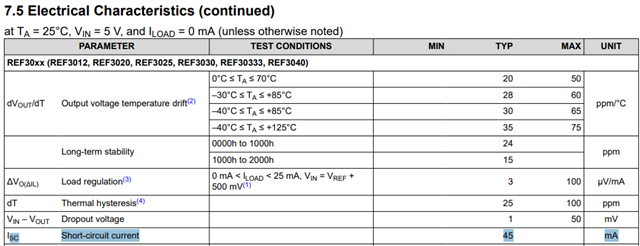

    What is meant by input current? REF30 has an output current maximum of 25mA. Anything greater than that will cause the device to fall out of datasheet specifications and potentially damage the device. We cannot guarantee correct device operation with a load current greater than 25mA.
    The short circuit specification can be seen in the EC table on page 6 of the REF30 datasheet:
    This is the amount of current REF30 will typically source when shorted to ground. This is different than the load current maximum of 25mA, and my recommendation to not exceed 25mA load current still stands.

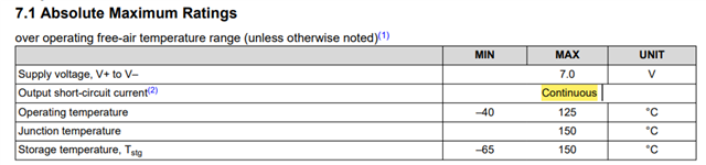

  • Jackson,
    What does this "continuous" mean?
    Joyce
  • Hi Joyce,
    This means that when REF30 is connected in a short circuit to ground condition, the output current will be limited to 45 mA typically (the number reported in the electrical characteristics table):
