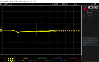

  • Hi Jeff
    I'll post here so others can benefit from this info
    Here's what the turn on sequence looks like on the scope.
    There's the Battery voltage DC offset of 16.5V at the time of measurements, I didn't use a fully charged battery just in case. Fully charged battery measures about 16.85V.
    You can see a first spike at ~1.6V and then a second one at ~1.3V which suggests that the 18V TVS I added on VSYS is doing its job.
    16.5V (VBat) + 1.6V (spike) = 18.1V
    To me, this is a good enough indication that the first spike may reach much higher if this wasn't for the TVS, and then toast the VSYS pin if it goes above the 20V threshold of the pin, especially with a fully charged battery. Just to be sure, I will test with a lower voltage battery, like 13-14V to see if the spike still reaches 18V and if so, this will conclude your hypothesis but I'm pretty sure you nailed it.
    Thanks again for your help!
