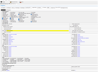

  • Hi Christian,
    Many thanks for the prompt response. I did enable the reserve mode, but nothing is happening. The following is the screenshot of the bit settings.

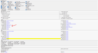

  • Hi Christian,
    Stil no luck with discharging. Here is the info on the Status registers.Your help is greatly appreciated. Thanks, Gamini
  • Hello Gamini,
    Your VSYS_REV is too low, the voltage needs to be higher than battery voltage.
    The BQ25820 is a buck charger in forward mode and a boost charger in reverse mode.
    Christian.

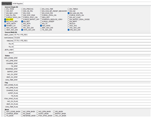

  • Hi Christian,
    I set that value to 54600mV and still not discharging.... Are there any jumpers on the eval board that has to be changed? Thx. Gamini

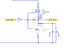

  • Hi Christian,
    How do you put the device in battery-only mode?
    What I meant was J2 cannot be switched ON/OFF as it is always hot whenever the battery is connected to J3. We don't want that as we don't want to hot plug either the load or the battery. We should be able to switch OFF the BAT voltage showing up on J2.
    The status says the BATFET is off...
    How do we switch off and on power on J2?
    Many thanks Gamini
  • Hello Gamini,
    Battery only mode just refers to the battery being the only power source. There is no entering battery only mode. it's just the condition of battery being the only power source.
    The BATFET is shutting off, but the power is still flowing through the diode of the Fet. If you want to completely disconnect this path, you will need two MOSFETS.
    You will need to populate Q8 and C36, and remove R1005/R1004
    Christian.

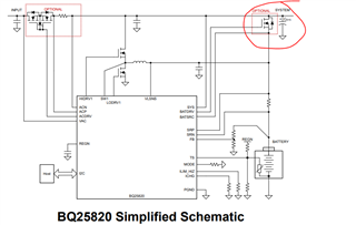

  • Many thanks. Christian. What is the purpose of J2? Is there a way to charge and discharge only using J1 & J3? In our case, we may not be able to have 3 connectors. I can charge the battery without J2 but cannot discharge.
    Gamini
  • Hello Gamini,
    J2 is the system load
    When the adapter is outside of the ACUV/ACOV range( adapter is removed) the ACFETS will be latched off and power is not able to flow to J1. We do not have a safe way for Battery to flow from J3 to J1.
    If you remove the ACFETS, the battery will be able to flow from J3 to J1, but when you plug the adapter in. The adapter will be shorted to battery. This could damaged the adapter or battery.
